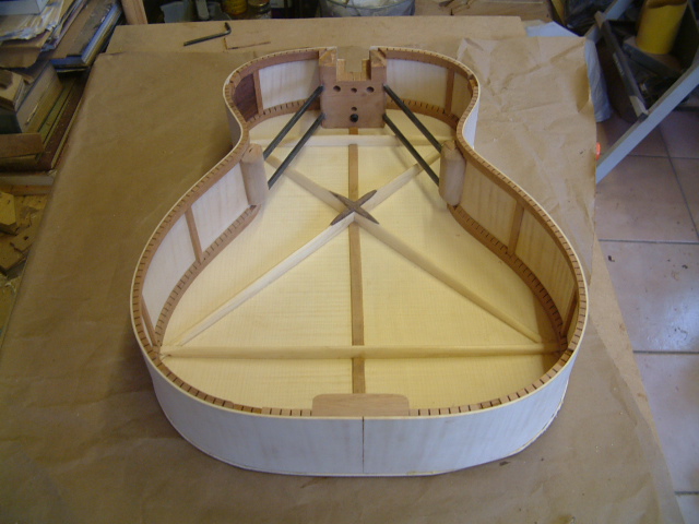

Philip,
I put mine here:
I use wooden side braces and have a pair on either side of the port. I sometimes put thin veneers in between the 2 side braces for extra stiffening and also to add interest around the port when it is cut as I don't bind them. You can just about see the side braces and veneers in this photo:
I have also used soundports with no extra veneers as well.
Hope this helps.Dave White38848.6100347222

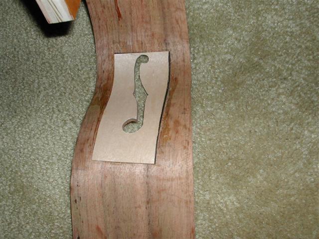

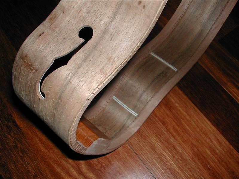

Here is a pic of a sound port I did on a bouzouki I'm just finishing up. I have already strung it up and played it in the raw, and I must say that it is the loudest instrument I have ever heard from such a small box. When I cover the soundport and then uncover it, I can hear about a 10% gain in volume from the players standpoint, but from the person listening, it is more like 5% change in volume or less. The best spot I think is between the waist and the peak of the upper bout, but very close to the peak of the upper bout, just before it crests. In these pics you will see that I used a maple/dyed black maple veneer to reinforce the area. I glued this in after the sides were bent by using a clamp with the soft styrofoam that will conform to any shape. Hope this helps, and good luck!
Pic of the port:
Here is a pic of the reinforcement:

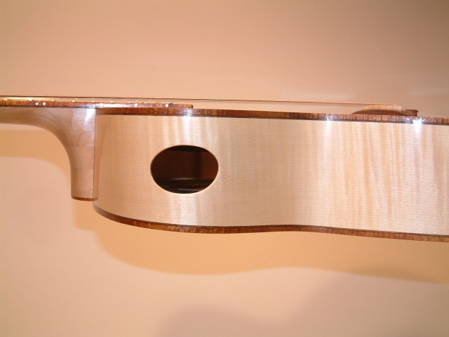

Here is a closeup of one of two soundports I installed in a client's guitar (on either side of the neck). I pretty much followed the guidelines that Robert Ruck, a highly respected classical builder, uses in the size and placements of his soundports.
I used alternating white/black veniers to give the port a bit of visual interest.

Dave: That's very nice! Is that Walnut on Maple?
Billy Dean
PostPosted: Fri May 12, 2006 8:04 pm
Billy,
it's maple with curly koa binding.

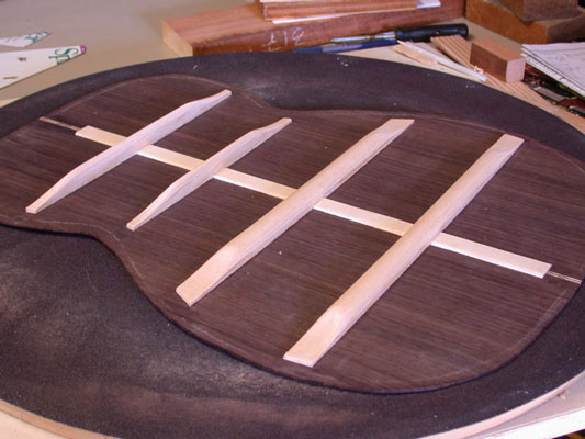

hey dave, what are the sound advantages of the x-bracing style on your guitar verses the lateral braceing? I was just currious as to the differant styles,by the way that sure is a beautiful guitar you have there............ i hope mine looks as good as yours opon completion.        & nbsp;
this style x - bracing verses
this style lateral? thanks
PostPosted: Sat May 13, 2006 4:26 am
Matt,
I went to the hybrid X/ladder braced back about 8 builds ago. I was looking for a more consistent arching for the back without having to "force" the front to back arch by gluing the back to the shaped sides. I also like the way the braces lock and that there are only 4 notches to make in the side linings.
Soundwise I think it gives slightly better overall projection of the guitar. Al Carruth uses forms of X braced backs as he says he can get a better back "tuning" that way although I don't conciously do this.
